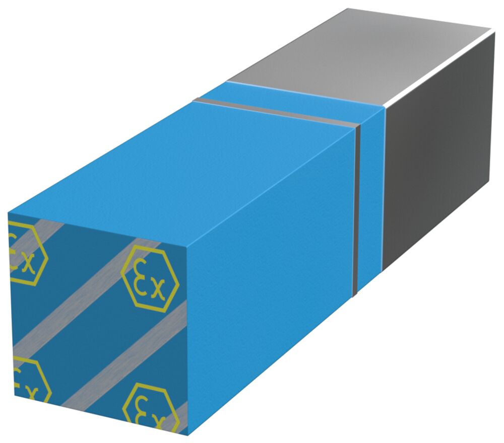

  4. Roxtec RM ES Ex module with Multidiameter™
Roxtec RM modules are 60 mm (2.362") deep and easy to adapt to cable and pipes of different sizes. The ES Ex version protects against high frequency radiated and conducted EMI/EMP in shielded environments and is used in potentially explosive atmospheres and hazardous locations.
RM 30 0+10-25mm ES B EX
Component articles
RM ES B Ex, with core
RM 15 ES B Ex
  • External dimensions WxHxD (mm) 15 x 15 x 60
  • Number of cables/pipes 1
  • For cable/pipe Ø (mm) 3 - 11
  • Weight (kg) 0.03
  • Art. No EXRMESB10015100
