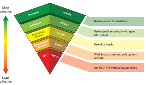

As per North American NIOSH (National Institute for Occupational Safety and Health) and UK Management of Health and Safety at Work Regulations stipulates, (see figure 1 below), the removal of risk by limiting access is the most efficient protection method. The second most efficient protection method is to replace the non-internal arc rated switchgear with properly tested IAC rated equivalents. By using internal arc rated switchgear you will make sure that the internal arc-flash and potential following explosion are contained.
Figure 1. Courtesy of the white paper “Internal Arc & Arc-flash in HV/MV Switchgear” by Threepwood Consulting.

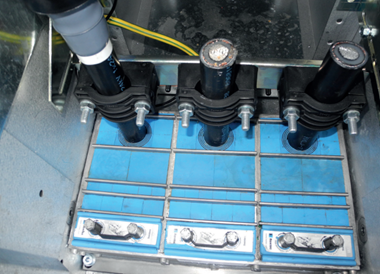

To successfully pass internal arc type testing, it is recommended to use mechanical cable sealing solutions, tested for blast and prevention of fire spreading. In addition to this, properly tested cable sealing solutions will provide protection for switchgear and other equipment against water and dust, both known causes of arc.
Figure 2. Roxtec cable sealing solutions used in an ABB internal arc classification test performed on a 36 kV SafeRing and SafePlus switchgear.
