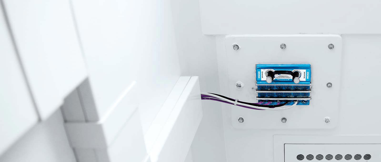

5. Seal cable and pipe penetrations
Cable and pipe penetrations are a common leak path that can decrease positive and negative pressure performance.  Cable and pipe penetrations should be sealed to mitigate air-loss and ensure positive and negative pressure room validation.
Do you want to learn more about cable and pipe seals for labs and cleanrooms? Continue reading.
