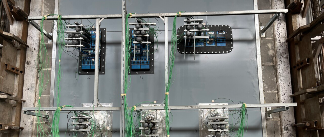

Extensive fire resistance testing
This joint effort involves extensive testing of the Roxtec GHM transit range on Eurobond panels in accordance with the EN 1366-3 fire standard. This fire resistance testing method for service installations specifically focuses on the penetration seals used in building structures. The standard ensures any openings for cables, pipes or services are stringently tested to see if they maintain integrity and insulation during a fire.
In accordance with EN standards
To achieve ETA certification, Roxtec tested the specimen in an accredited external test facility containing Roxtec GHM transits and lightweight Roxtec FlamePlus™ transits with cables installed. The transits were mounted in vertical 200 mm thick Eurobond Rockspan panels for testing. The test was in accordance with EN 1366-3:2021 and followed the heat curve for fibrous fire stated in EN 1363-1:2020. The cables in the standard cover vast cable types currently and commonly used in building practice in Europe.
Excellent test results
The Roxtec GHM transit and Eurobond panel fire solution managed an EI 120 rating which means the temperature rise on the unexposed side was below 180 degrees and the partition was intact after two hours of continuous fire where the temperature exceeds 1 000 °C after 90 minutes and continues to rise during the test. The Roxtec FlamePlus™ also achieved up to EI 120 fire rating with a similar set-up.
Based on these excellent results, we are now waiting for official fire resistance ETA certification for panels so we can further guarantee safety within cable and pipe sealing.
